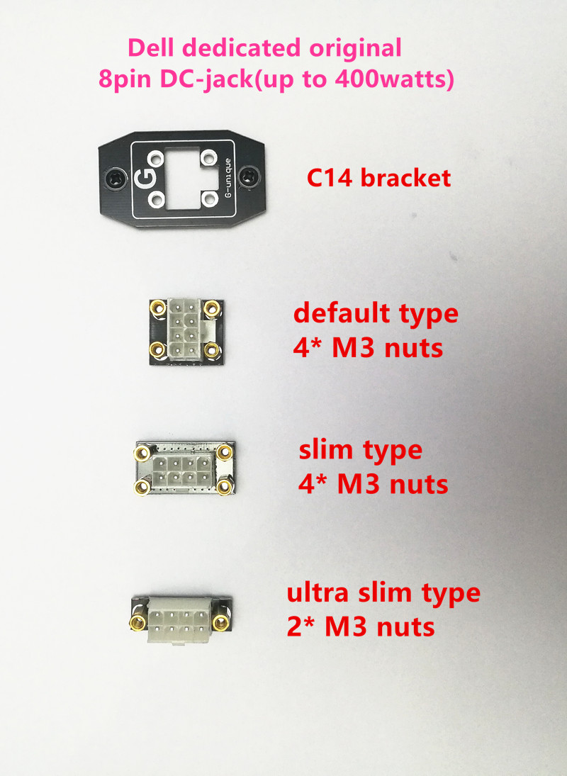

if requested upon order, can you change the dc plug in to an 8 pin like this 8 pin default type wth 4 mounting holes?
https://img.alicdn.com/imgextra/i2/40167061/TB263zHrJRopuFjSZFtXXcanpXa_!!40167061.jpg
Yes, that's not a problem at all.

Is it have mounting hole for G-UNIQUE TYPE C? (TYPE D is nolonger available)
if not, shoud i buy mounting bracket like dell c14? (https://img.alicdn.com/imgextra/i2/40167061/TB263zHrJRopuFjSZFtXXcanpXa_!!40167061.jpg)
If you didn't order the unit from Gury yet - please ask him for the "Ultra slim type 2*M3 nuts". It's supported out of the box. We can also make the adapter for the "Default type 4*M3 nuts" on request. "Slim type 4* M3 nuts" is also possible but we would need the drawing with precise distance between mounting holes.
