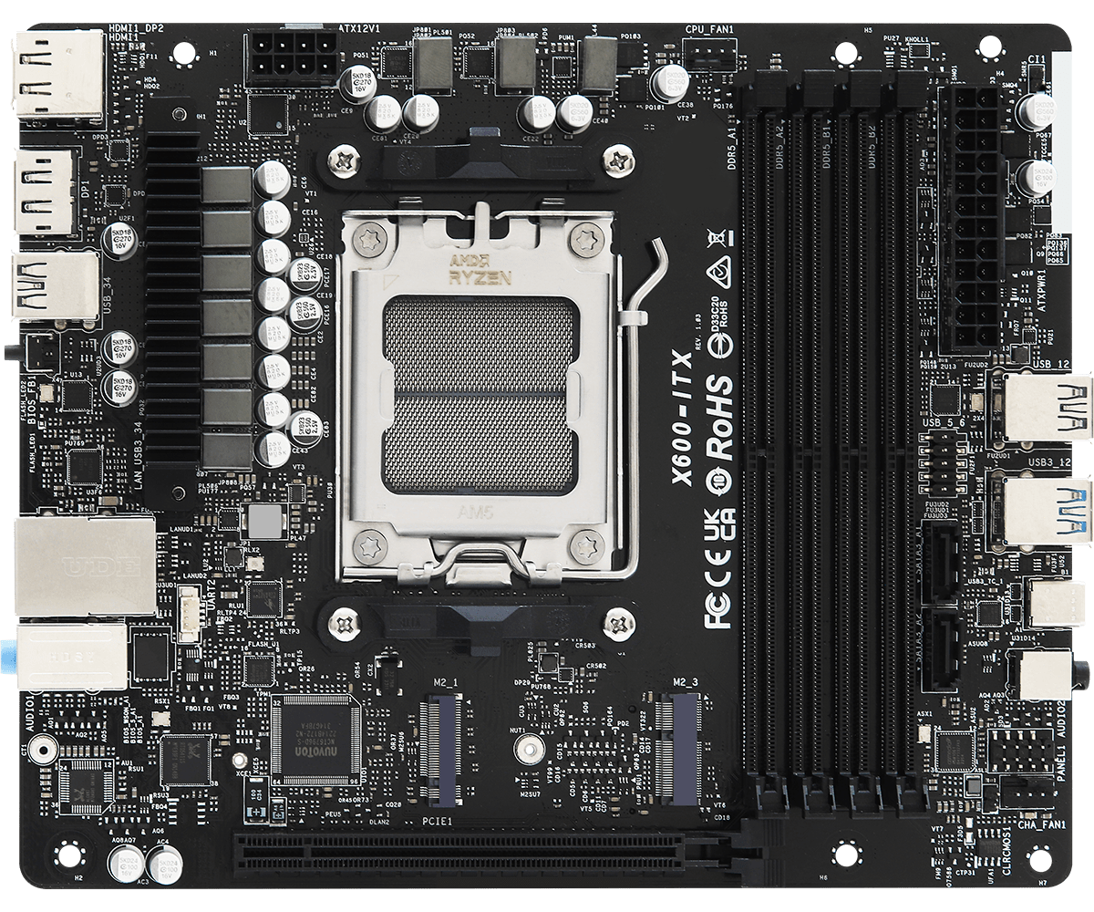

Hi,
I saw in a picture on heise.de that the x600 chip can provide 28 PCIe5 lanes in conjunction with a suitable CPU. Does anyone know why I can't use it on this board? The pcie x16 slot is only pcie4 in the specs.
direkt link to the picture:
Yes, per your linked article, Zen4 has 28x PCIe5.0 lanes on the onboard IO controller
So I mean it's theoretically possible, but I'm not sure you'll ever see it happen, it would depend on how board manufacturers design the PCB in terms of physical/electrical/signal performance but more importantly how they would be able to market it and actually make money. I'm not entirely sure how it's relevant to this board, however, as there's no x16 slot anyway - only 2x M.2 slots (one of each 5.0 and 4.0)
