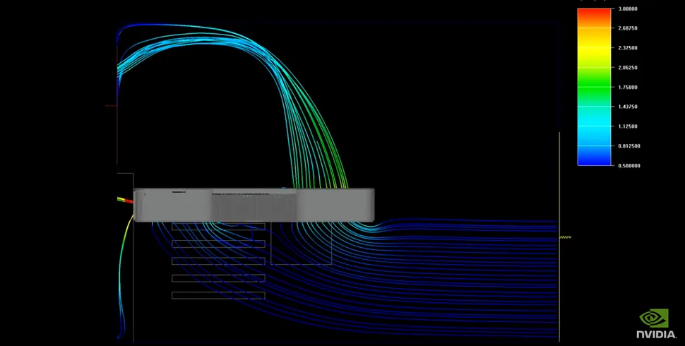

Well....I took out my crystal ball just for you and it comes out with this prediction...lol
See the pic below for having a 3090 FE edition (and perhaps a 3080 as well?) inside a T1.
Fresh air is still going through the side mesh panel. The (secondary) fan (ie the one nearer to the back PCI holder) draws air in and exhausts out the rear, in a 'push'. The (main) fan also draws air in (through the side mesh and through the card's heatsink fins) and exhausts, in a 'pull'. As it is so close to the PSU sitting behind, the exhaust air will rely on the fan on the case top for extraction.
The design airflow is more of a traditional path (ie case front lower fan intakes air into the case + case rear top fan exhausts air out of the case). As such, fresh air is supplied to the both fans of the 3090 from the front (vs from side mesh panel). The pic below shows this 'reference' design.
It could be an oven for the reference air cooled 3090. Who knows?
As an engineer, I know from years of experience that there are always problems waiting to be solved in a new project. Same goes to most things in life. I suppose, we can adjust our attitude and 'headache' can become 'interesting and satisfactory'.
I wonder if pointing the PSU fan opening towards the GPU would be better here. Air can nicely enter the PSU (which lets be honest, isn't ALL that heat sensitive) and of course the air won't stagnate, as if the GPU is hot (meaning drawing power) the PSU fan will also be turning, helping move GPU heat into and then out of the PSU exhaust, aided further by the exhaust fan at the top of the case (assuming "flipped" PSU orientation).
SF750 fan is thermal sensitive and so it can be triggered on earlier by that extra heat from the PSU, even if the system load is low.
Assume 3090 has 350W to be dissipated (conservatively speaking). Maybe, 200W will be handled by the main fan and the secondary fan will send 150W to the PSU. This should not be a too big an extra heat load for the PSU.
So, making use of the PSU fan should be the first solution to be tried, IMHO.

As I mentioned before the best way is to point psu exhaust into radiator and make a fan swap/mod in order to control psu fan speed and push extra air as well as keeping psu cold at all time.
some would say that it's dangerous to play around psu so you better to know what you are doing.

I'm extremely excited about the idea of making the 3090 reference cooler work in the T1.
If it does work imo it could work even better than conventional coolers that expel hot air all around the case in an extremely inefficient way. The 3090 gives us the opportunity to control where the expelled air goes. Flipping the PSU might do the trick, if it doesn't swapping the fan like @x111 suggests is the best alternative (need to be very, extremely, life/death situation cautious of course)
