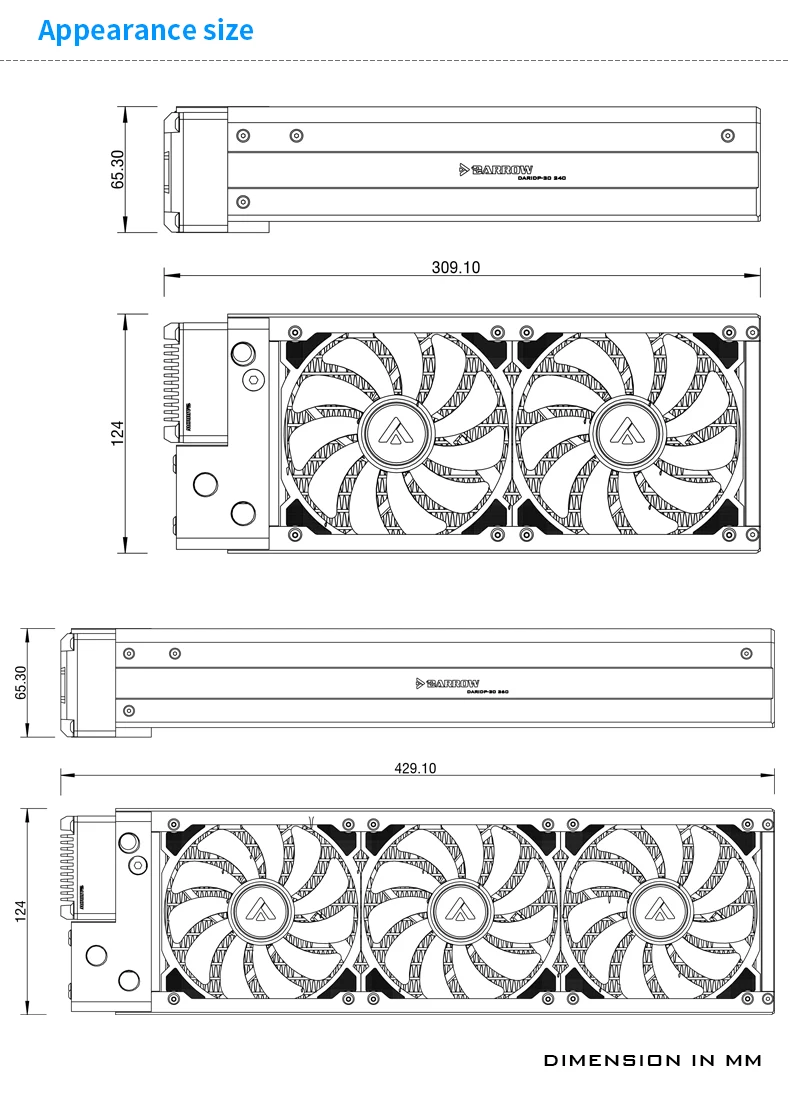

GPU size up to 330x130x63 (in 240 mode or air cooling mode) or 215x130x63 (in 360 mode).
are those numbers still true? because this drawing tells something else

I still can't get watercooling the GPU out of my head so I've been doing a little bit of research. With a total case length of 356mm, if we take a 360rad with exactly 120mm width (there are wider models too) it leaves us with 236mm for the GPU. 356mm probably being outer dimensions and taking into account tiny gaps between case-rad-gpu I think it's safe to assume 225mm AT MOST for the GPU block (if not the 215mm stated by Sammy).

Approximately 216 mm depending on the rad width
This would rule out even more blocks. I've decided to drop the idea of a full custom loop. After all it seems like a single 360rad is not capable of handling the heat of a modern highend CPU and GPU anyway.

I've ordered most of the parts and I'm going with a CPU block and separate pump/res, but now I'm wondering what is the maximum length for the GPU block when going with a 360 rad?
It depends of rad's wide. If you use standard 120mm wide one, the maximum length of the GPU block is 230mm (but optimum is 225mm i think).
Found a Alphacool GPX-N 3090 FE block fairly cheap in an outlet and I will attempt a full custom loop. The block officially has 231.5mm but I'll just see if I can fit it :p maybe sanding off a tinyyyy bit of the block and/or deforming the rad a little :D but if it doesn't work I'm gonna sell it. Not sure if I should feel excited or a little crazy :D
