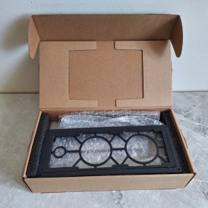

Talking to a friend with a 3D printer the other week, he said he had considered it but hadn't justified a test print of the frame, so would be happy to print one out to see how it works and for me to have a play with it.
Here it is as delivered a couple of weeks ago
There are 7 parts to the frame: Front plate, Front fan filter holder, Back plate plus the 4 support beams
