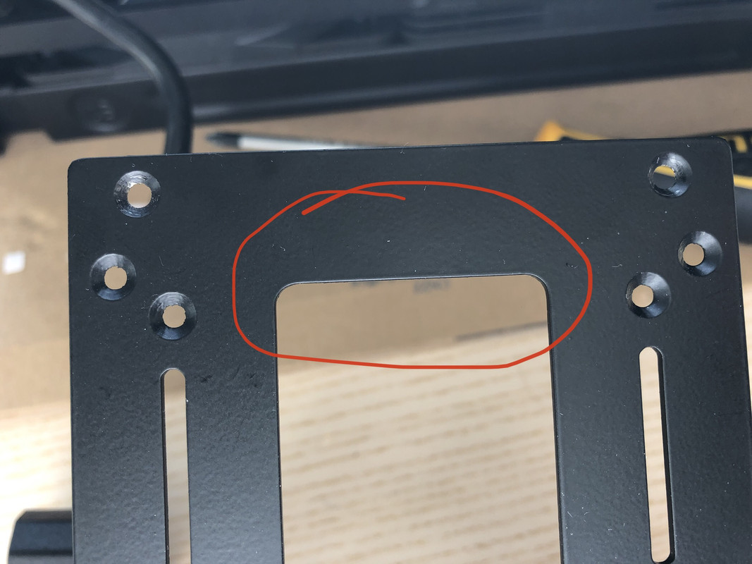

After one day spent to make custom cable for the 180 PSU configuration, I've realised that there is a clearance issue between the radiator 90 degrees fitting and the power cable extension! So, It's not gonna happen for now! Maybe I will use a straight one next time I drain the system, but I am still convinced that is not worth it, because it means a longer 24pin ATX cable and longer CPU EPS cable.
One suggestion for @Wahaha360 : i suggest to cut higher the central opening of the plate to mount 180 degrees the PSU. Or even remove it, to have a sort of U shape.
So you have space to route easily custom cable from the PSU to the GPU!
I see, good suggestion. I how much do you think I should cut?
What about like this?

What do you mean buy this photo? https://smallformfactor.net/forum/proxy.php?image=https%3A%2F%2Fi.postimg.cc%2Fsg524w5G%2FIMG-2560.jpg&hash=6753e4ee9a10564286df74ca2d09c8e2
Excuse me for not understanding this, what does U shape mean here? Wouldn't you able to route the cables from PSU side to GPU side with current design?
The top spine where the bracket attaches blocks the cutout you've made. One suggestion is to get rid of all the metal to make a giant U out of the bracket.
Picture 4 and 6
I believe @fabio means to do this:
