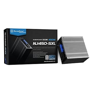

Mmm there is no ventilation behind the psu, for example i have a fanless psu and it will be good if the case have some air slots behind.
added to the fact that most sfx psu are more warmie than the normal ones.
Concern I have with adding the venting for PSUs back there is that that side of the case is intended to be the exhaust side. When the case is laid down the exhaust airflow will get trapped between table surface and the exterior of case, and will loop back into the PSU and greatly increase temps / fan speeds.
I think with both 120mm slim fans running your fanless PSU should be fine - they really over engineered that thing.
