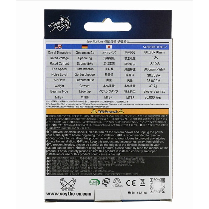

Sources:
1) https://down-id.img.susercontent.com/file/id-11134201-7qula-ljs5rukyeb6y42
2) http://www.scythe-cn.com/product/cooler/sc-jt8039-p.html
3) http://www.scythe-cn.com/product/cooler/sc-jt8039.html
Notes:
Bundled with the Scythe Jitte SC-JT8039 and Scythe Jitte Plus SC-JT8039-P.
Can be bought separately.
This is 4-pin PWM only.
Fan NameScythe Kaze-Hachi, SC8010KH12H-P
Motor BearingSleeve
Motor Speed3000 RPM
Static Pressure? inch H2O
Airflow Rating25.8 CFM
Noise Rating30.7 dBA
Power Rating12 V, 0.15 A, 1.8 W
Mean Time to Failure30,000 hours @ ? C, ?% relative humidity
Where to BuyAliExpress, Taobao

Sources:
Notes:
Motor BearingSleeve
Motor Speed3000 RPM
