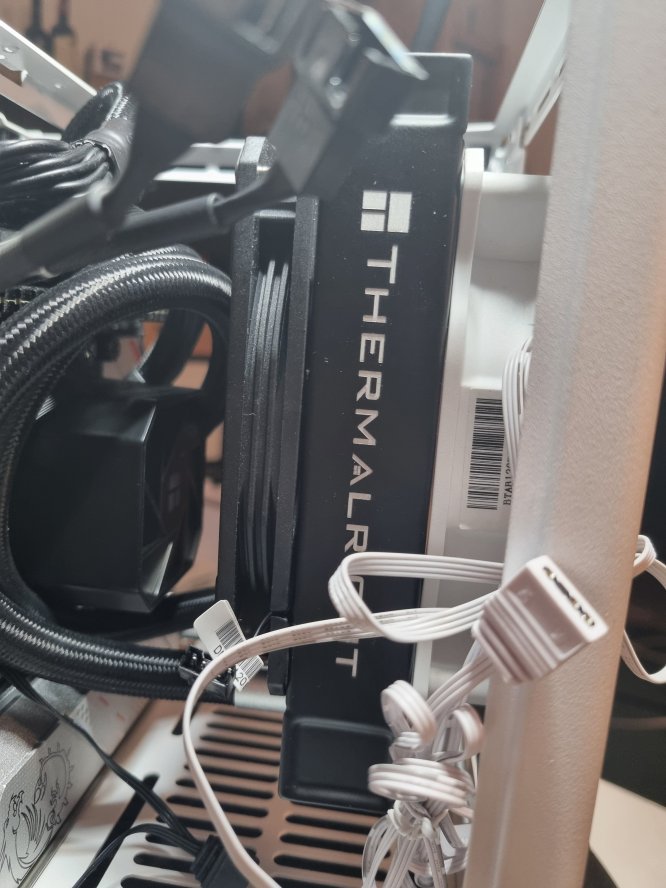

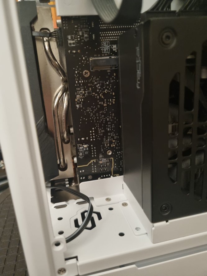

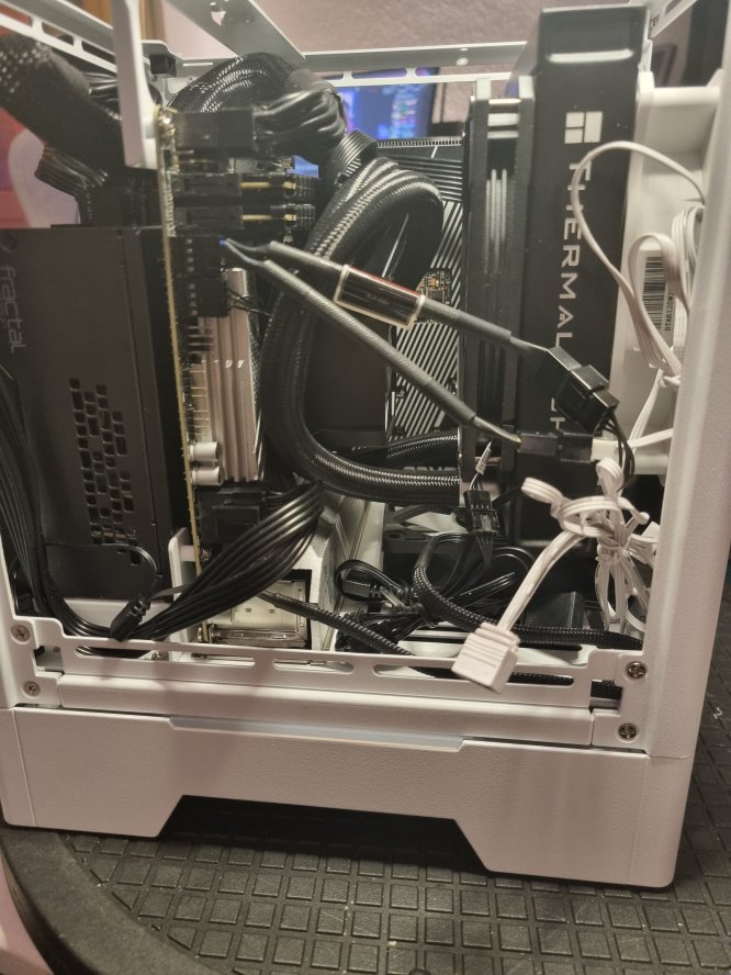

PSA: Maximum thickness for a GPU in the Nouvolo Borg is 51 mm. I just managed to wiggle my Asus Phoenix RTX 3050 V1 in, and the panel closes without bulging! 😅 🥳

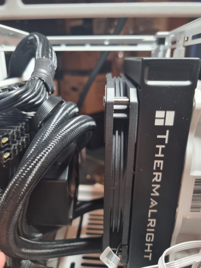

Also, AIO is in, and hopefully the tubes wont put pressure on the fan itself. Else I have to unmount everything and add a fan guard.
Next challenge: Installing the on/off switch ON THE MAINBOARD without breaking my fingers 😅😱

so I had to unplug and pull out the GPU to get the power switch installed *sigh* 😔
but nevertheless, this rebuild is almost finished 🥳 .. still need to figure out the ARGB routing + control, and also optimize airflow/cable routing/fan curves, but aside of that, everything is done AND WORKING!
just did a test stream, and everything stayed at decent temps 😎

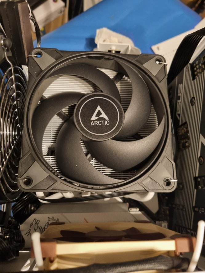

Currently experiencing a bit of noise, its either related to the Silverstone fan, or just the AIO in general. Gonna replace the fan in a bit with another P12 Max, and hope the noise level is gonna go down. Else I'm going to switch to air cooling with the Silversoul 110.
cu, w0lf.
hrh_ginsterbusch
Nov 18, 2021
1,090
460
Germany
wp-devil.com

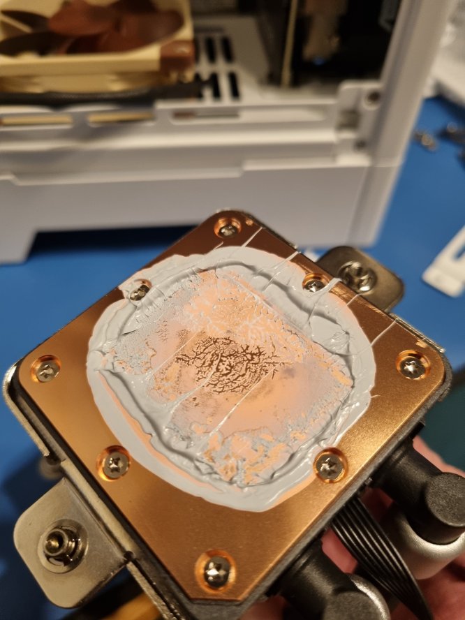

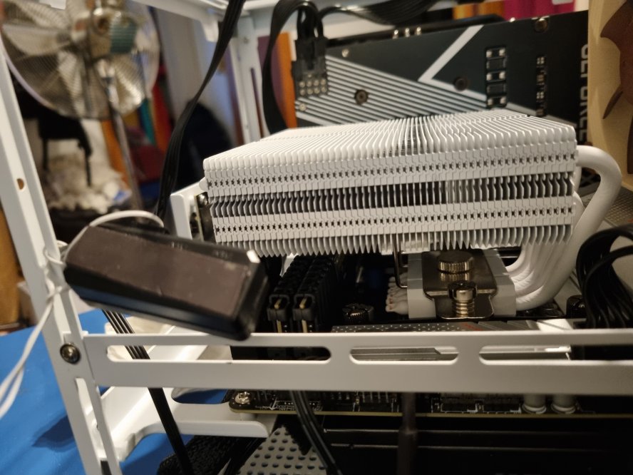

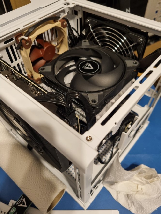

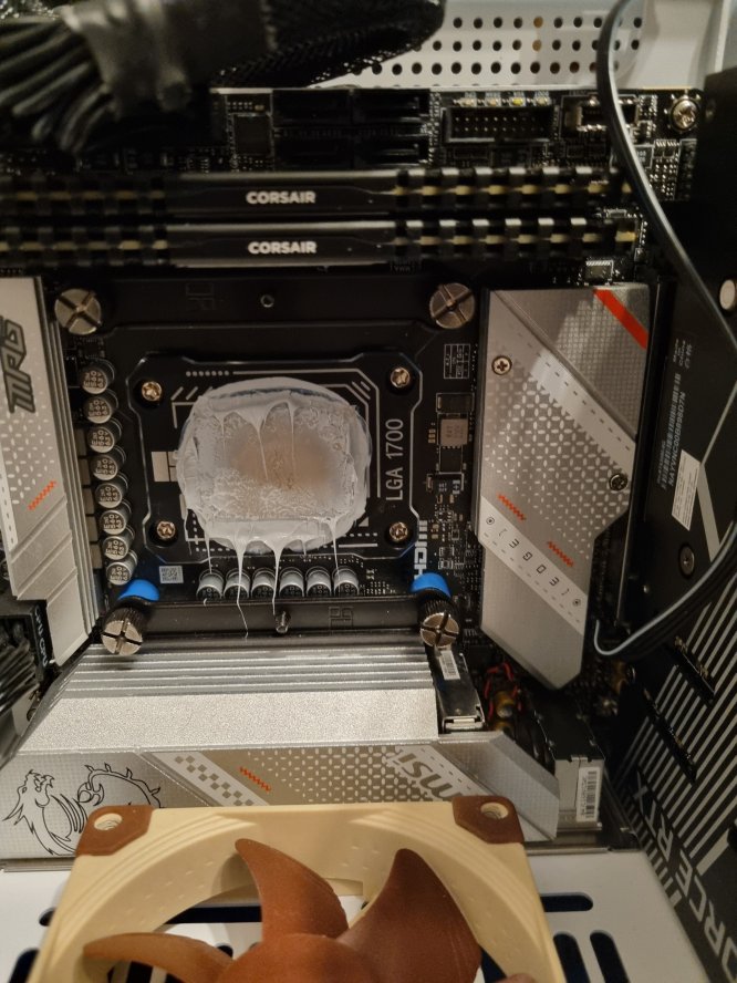

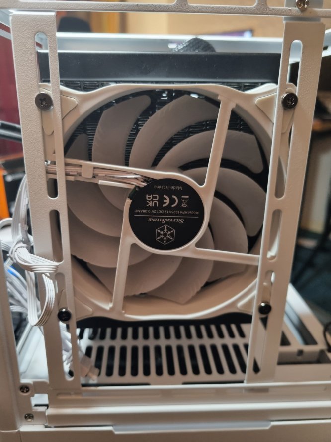

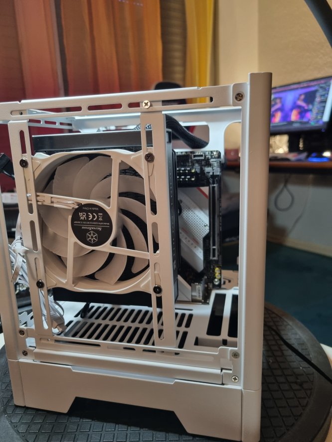

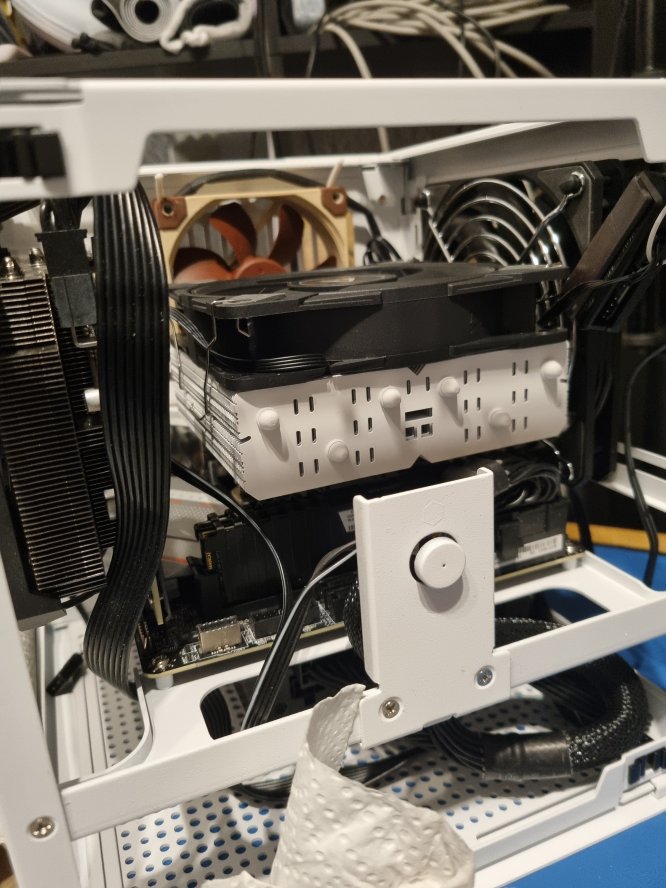

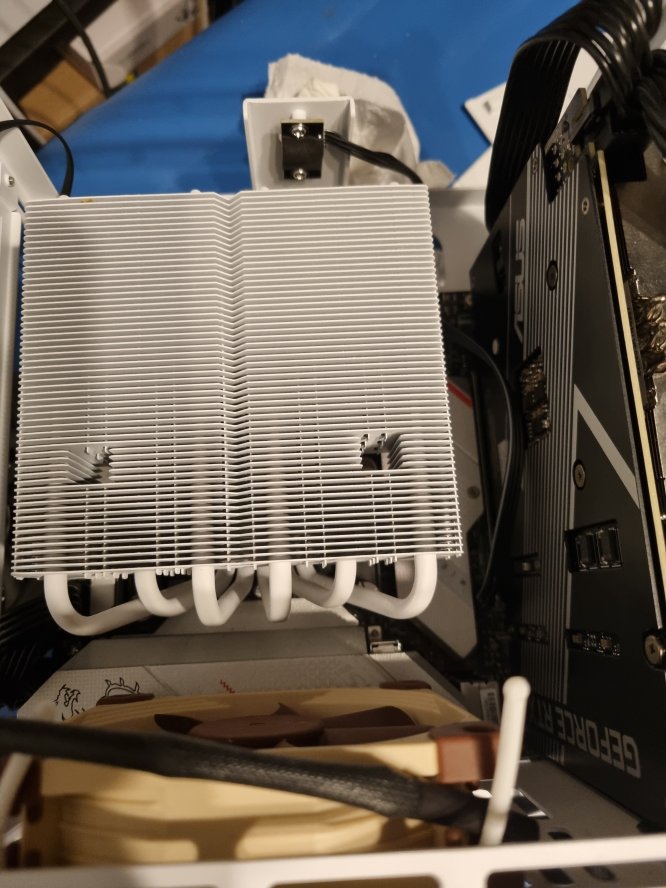

Changing the fan improved the noise situation by a lot, but the AIO pump is still noise AF, too. So today I replaced the whole setup with the SI-100 + the very same P12 Max. Oh, and new thermal paste, which was even worse to apply than on the AM5 system: Arctic MX-7. Texture like old chewing gum. On the other hand, the Noctua paste was a gooey mess. Yuck.
New temps as soon as I got the 15 m cable roll I ordered around; cause that blown fuses several times in a row this weekend was kind of .. ugh. Lets hope things get better if some of the load comes from other rooms.
cu, w0lf.

Instead, have some aesthetics for now: Replacing the 120 AIO with the SI-100.
