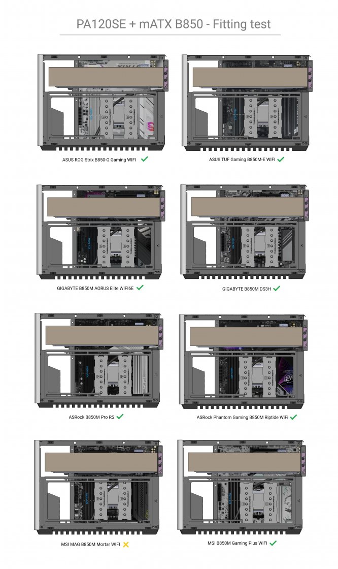

C4-MATX:
This why i hate mATX: "the CPU socket position can vary on vertical and horizontal axis, while on ITX it is mostly on vertical only.
I made some fitting tests with some mATX boards and PA120SE to see if heatpipes does clear AIO bracket cutout. Looks like only the MSI MAG could have problems. BUT heatsinks are a bit flexible so i think it will fit.

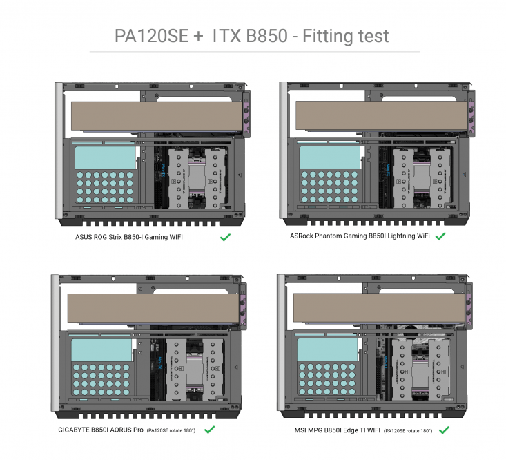

and ITX:

C4-MATX:
and ITX:
apparently Gigabyte clashes with this convention, too. Acc. to various sources, they seem to position the sockets 1 - 2 mm higher than other manufacturers, including ITX boards.

What a task!
I am using the MSI MAG 850M board and the CPU socket location is vastly different than what I am used to with ITX.
I had to skip the offset mount with my U12A due to collision with GPU. :(
