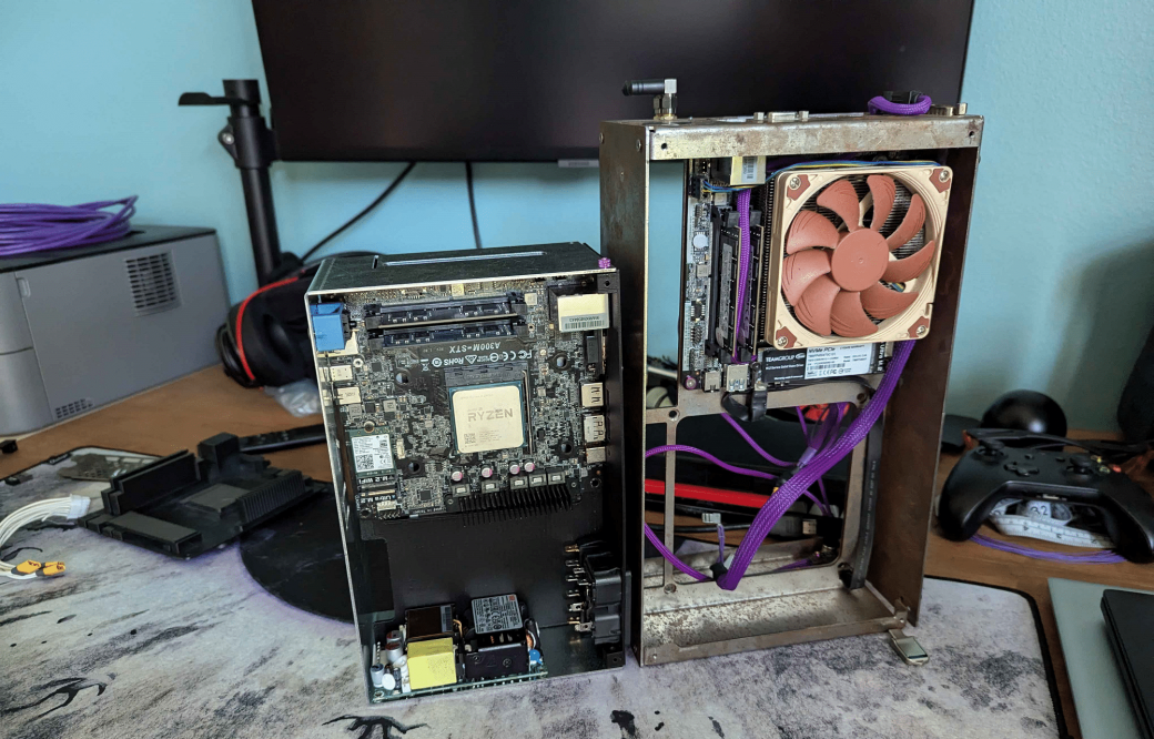

I went on a week long trip for work, and really hated how much space the X300-M(AX) took up in my luggage, especially since I had flown it and removed the watercooling, leaving a ton of space unused.
And to make it worse for the case, I designed it with specifically 2 slot GPU's up to 300mm in length in mind, and right after I finished it, it seemed like all the GPU manufacturers decided 2 slots are for idiots and 2.25+ is the way of the future, so the GPU market kinda killed the X300-M(AX).

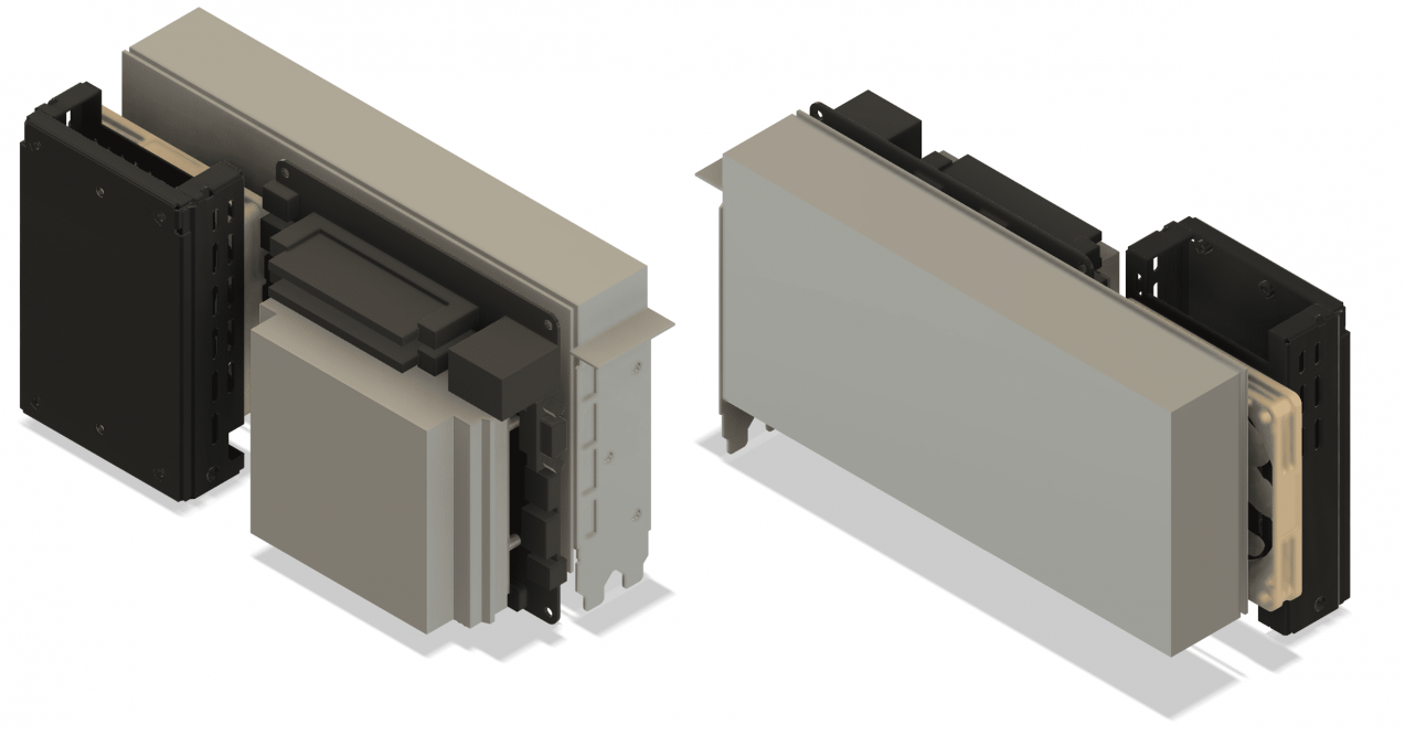

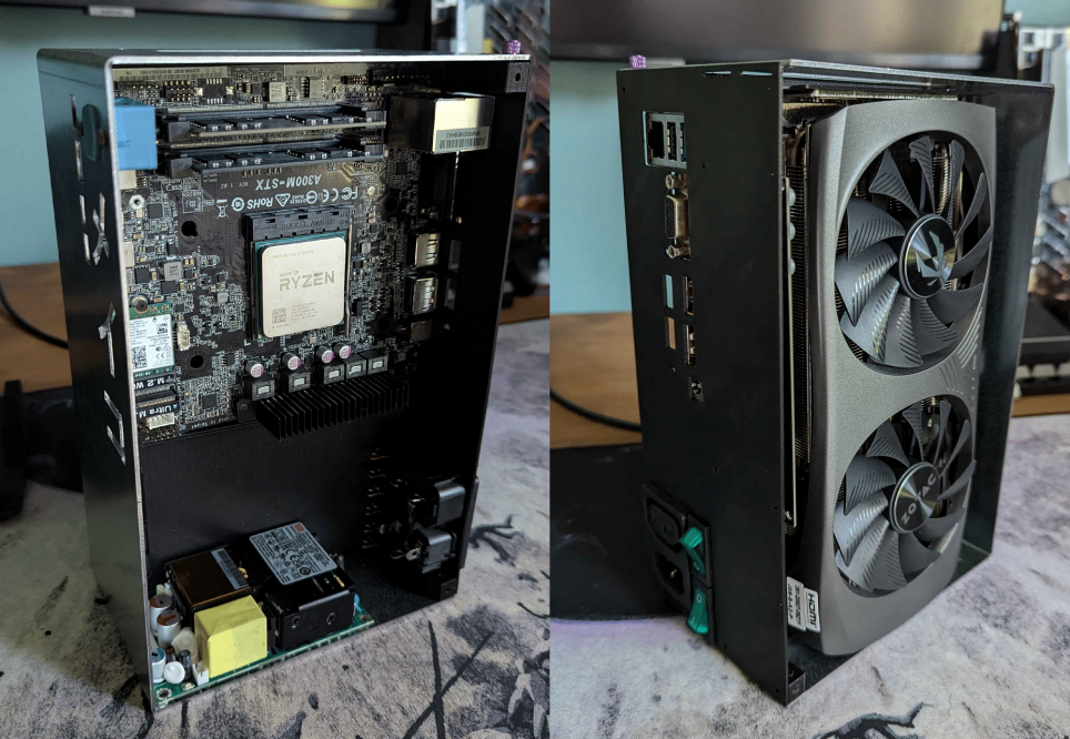

I started off by scheming about building a X300/WLP350-1003(from my last build)/4060LP in about 2.4L, which would be a sidestep from the RX6600 I had at the time:
I ended up staying with the sandwich design, but moving to a larger design with my RX6600 in mind.

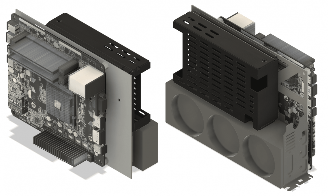

You can see the similarities in the layout early on, notably the RX6600 took vertical space by not being an LP card, but because it was longer It left plenty of room to fit the WLP350-1003 next to the motherboard:1755743191038.png
It was also around this time I was playing HD2, and very unhappy with my performance so I upgraded to a Zotac Twin Edge 4070 Super, choosing it specifically because of it's length + 2 slot formfactor. The SFFN review played a big part in my choosing it!

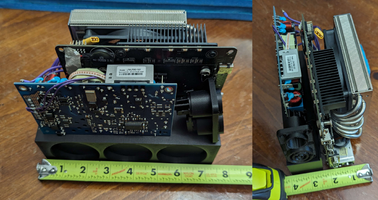

Browsing the SFFN Forum/discord, and the r/sffpc custom case discord channel, maybe @REVOCCASES discord, I came across the Meanwell LOP-300-12, a much smaller PSU that is nearly as capable as my existing WLP350-1003.
At this point I was using a 3d Printed frame for standoffs, and planning to bolt an aluminum plate to it for heat sinking, which may or may not have worked out, but I ended up ditching it for a fully metallic spine later on. You can kind of see it in the picture above where the Mobo side is the generic F360 grey, and the GPU side is blackish to emulate the CF Nylon I intended to print the main spine out of.

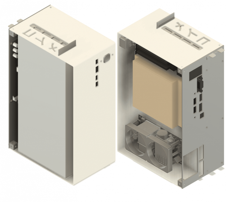

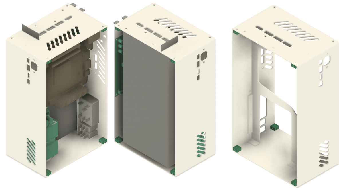

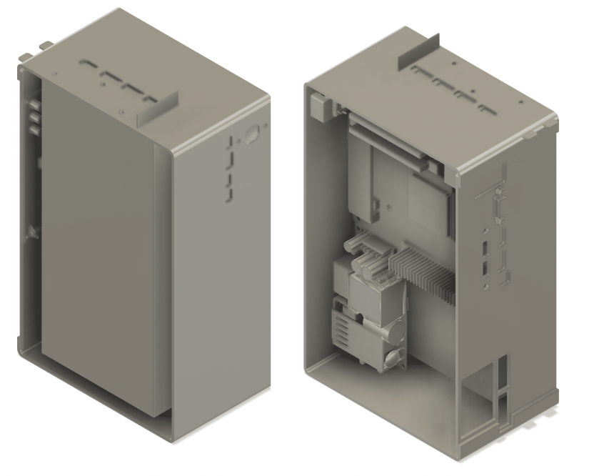

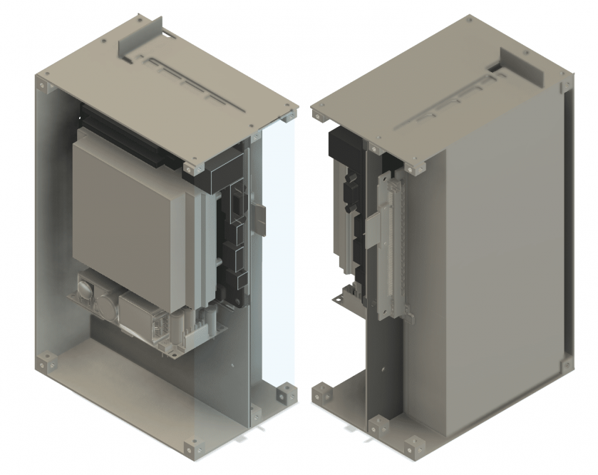

I completely started from scratch to clean up my fusion timeline, ambitiously calling the new file '4070 Project v2 clean final', LOL.
Noteworthy changes being the deletion of the Meiko theming, and a SLIGHT volume increase to allow me to rotate the PSU 90*.
I also moved to a single large flange for the main body, planning to attach the rear panel with little flange tabs to the main panel (this would be foolish in the end)

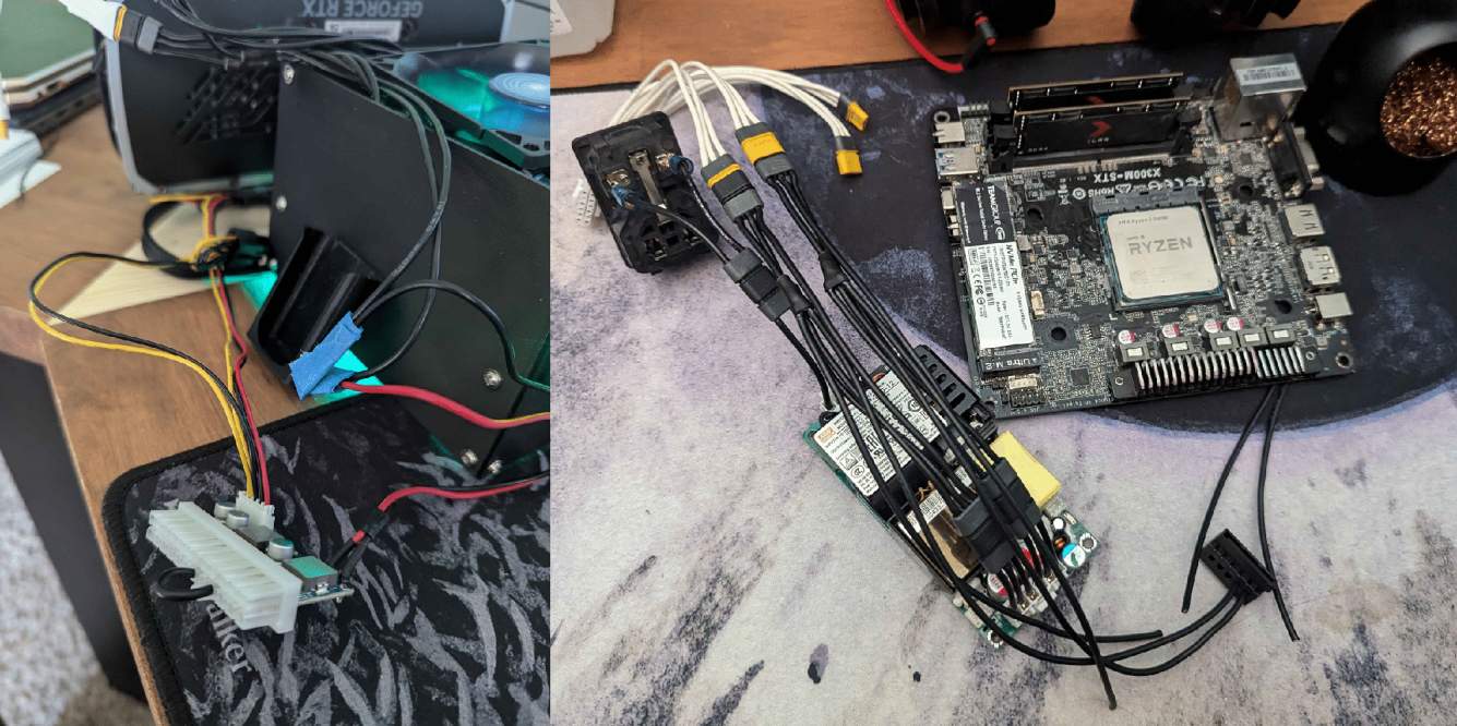

Here's some pictures of the wiring, and testing.
The riser I was using was new to me, and unlike my old ADTLINK riser from my last build that was happy with just 12v to run the GPU, this new one wants 5v as well from the sata power connector. So I sourced a random picopsu, hooked up it's sata input and cut wires until it wouldn't boot. Specifically I knew I needed 12v, so I just tried cutting 5v on one sata power connector, which killed the system power, and then swapped to a fresh sata power connector and cut the 3.3v which had no effect.
My initial reaction to this discovery was to desolder the 24pin connector and solder a jumper to the picopsu + some 12v outputs for the riser and motherboard.

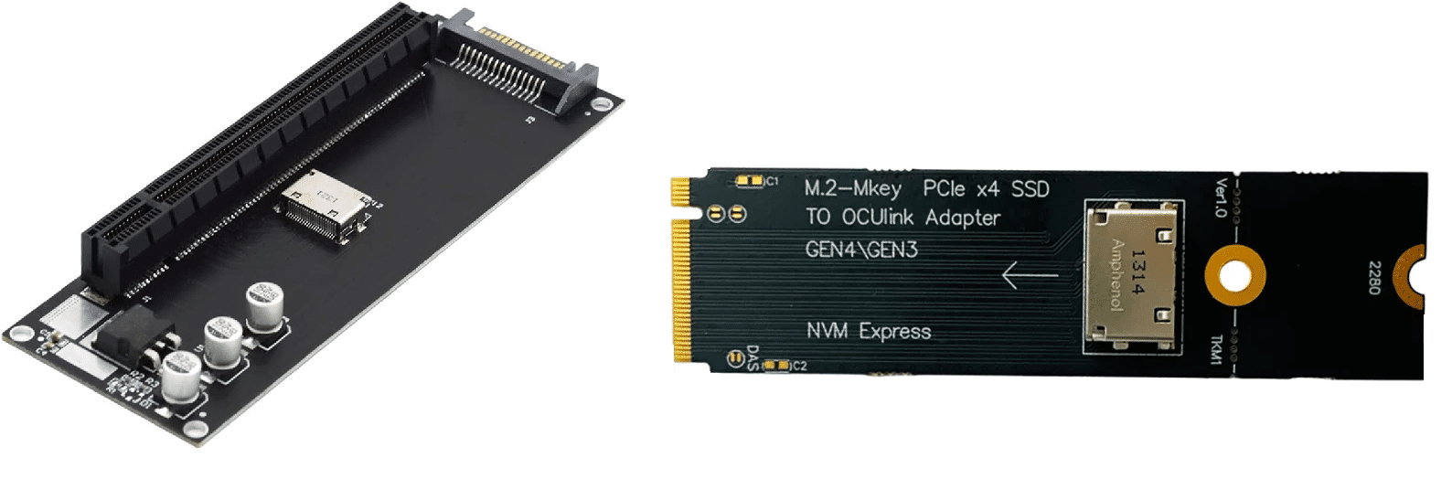

If you're curious how I'm connecting the GPU, here's the secret sauce; and OCULINK to M.2 and OCULINK to PCIE adapter pair:

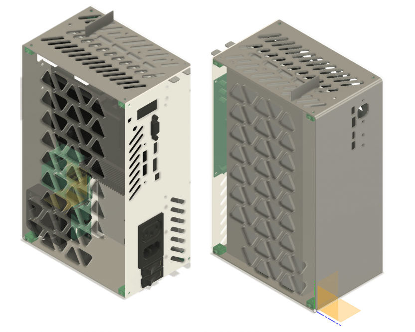

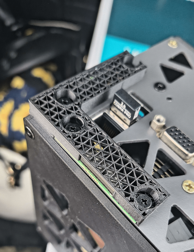

I saw someone in the r/sffpc discord using triangular venting, and liked it. So I told him I was gonna borrow it for my one-off and he said sure. :)
I also found out during some testing I didn't photograph well, that the top panel needed a LOT more venting, so I turned it into swiss cheese, lol.

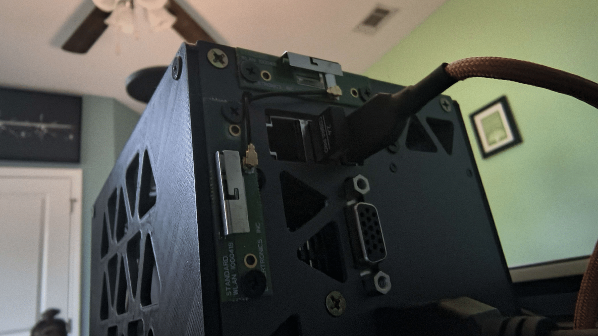

I also finally modeled in the wifi antenna holes, but after installing them I really hated how far they stuck out compared to the rest of the case.

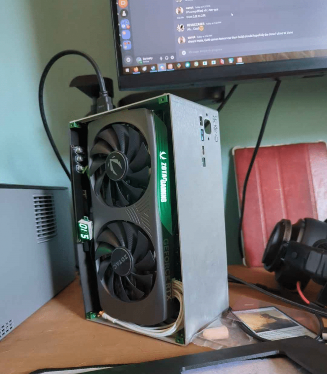

In the model the PCI bracket protrudes from the rear of the case, but in real life the 4070S is directly attached to the top of the case with the same screws that hold the bracket in place normally.
~February/March 2025
After fine tuning the Digikey antenna filter criteria very specifically, I found the perfect answer to my woes:
The KYOCERA 1000418 RF ANTENNA 802.11a/b/g/n/c, Bluetooth, Wi-Fi, WLAN, Zigbee™ Stamped Metal U.FL Screw Mount
The only issue would be that once I finally bought the right U.fl antenna wires, was how do I protect those delicate antenna elements?
The answer: A special made 3d Printed cover, not only does it protect the fragile mounts and easily disconnected U.FL connectors, but it also disguises my remnant WiFi antenna hole that I kept just in case these antennas didn't work out.
I did end up touching up the design for this before I lost it entirely somehow, and I tightened up the screw reliefs, and changed the exposed infill percentage.
Also covered that exposed section of antenna.
You can also see here my triangular venting has now moved across the whole PC for continuity, and it was working well.

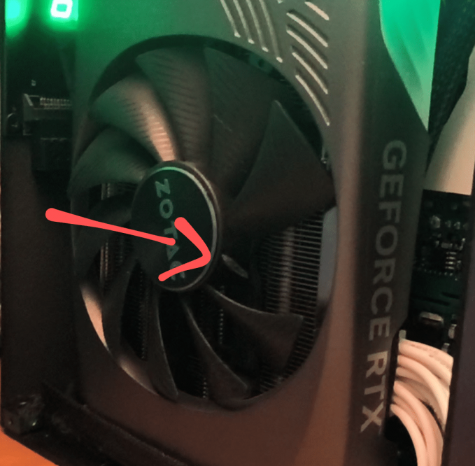

That was, until I picked it up wrong and the over-flexible printed panel on the GPU side flexed into the 4070S' rear fan, instantly snapping a blade off.
I was without a GPU for 45 days while I waited on Zotac to graciously warranty it for me. Right after I started playing CP77 for the first time too! D:

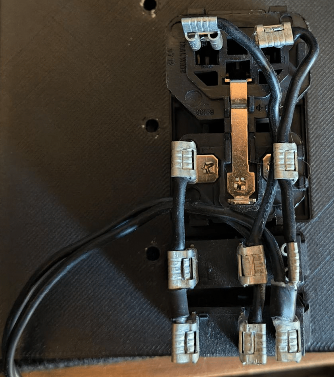

Also for those curious, my power inlet wiring:

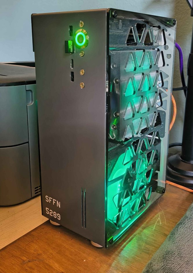

At this point I'd finally fully abandoned the Meiko theming and shifted to the idea of going for an MC-130J theme.
That meaning, satin grey exterior, zinc plated countersunk phillips head screws whenever possible and visible, and a gloss white interior.
Unfortunately I didn't prepare the aluminum correctly, and while I got away scott free on the rear panel which you can see in some of the wifi antenna pics, the U panel gave me hell. The satin grey did just fine, but when I masked that and painted the interior gloss white, it bubbled all over the place, requiring a full repaint ;-;

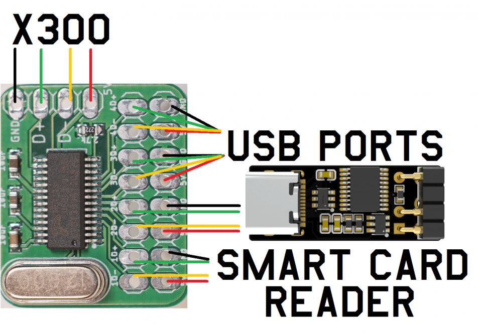

For my USB accessories (2 ports on the rear, smart card reader, Nollie1 ARGB controller) I used a Retrocution tiny USB hub paired with someDIY custom internal USB wiring. It's wired as such:

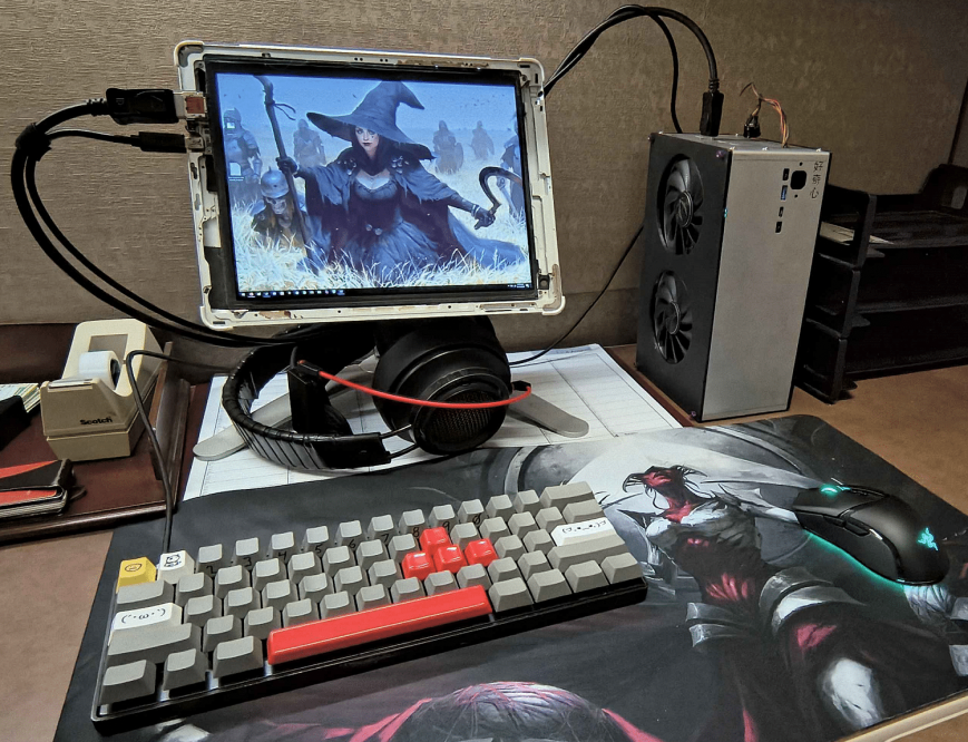

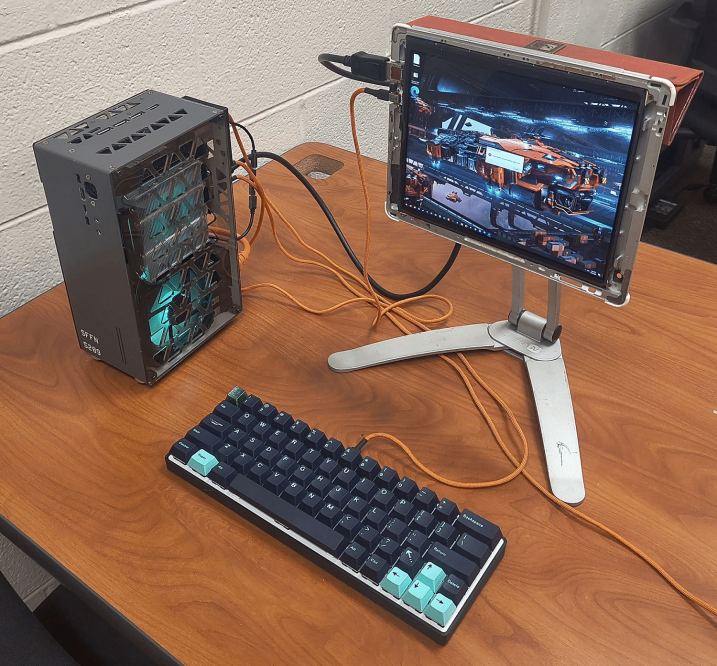

It is, COMPLETE! (or as complete as a project can be).
I took it to Quakecon 2025 and had a blast, it was so easy to move and setup, a great experience as always.
I took my iPad screen that's been in a few pics here so far, as we as a brand new 2k 144hz 16" Uperfect display for 2Q25, it was a great pairing.
