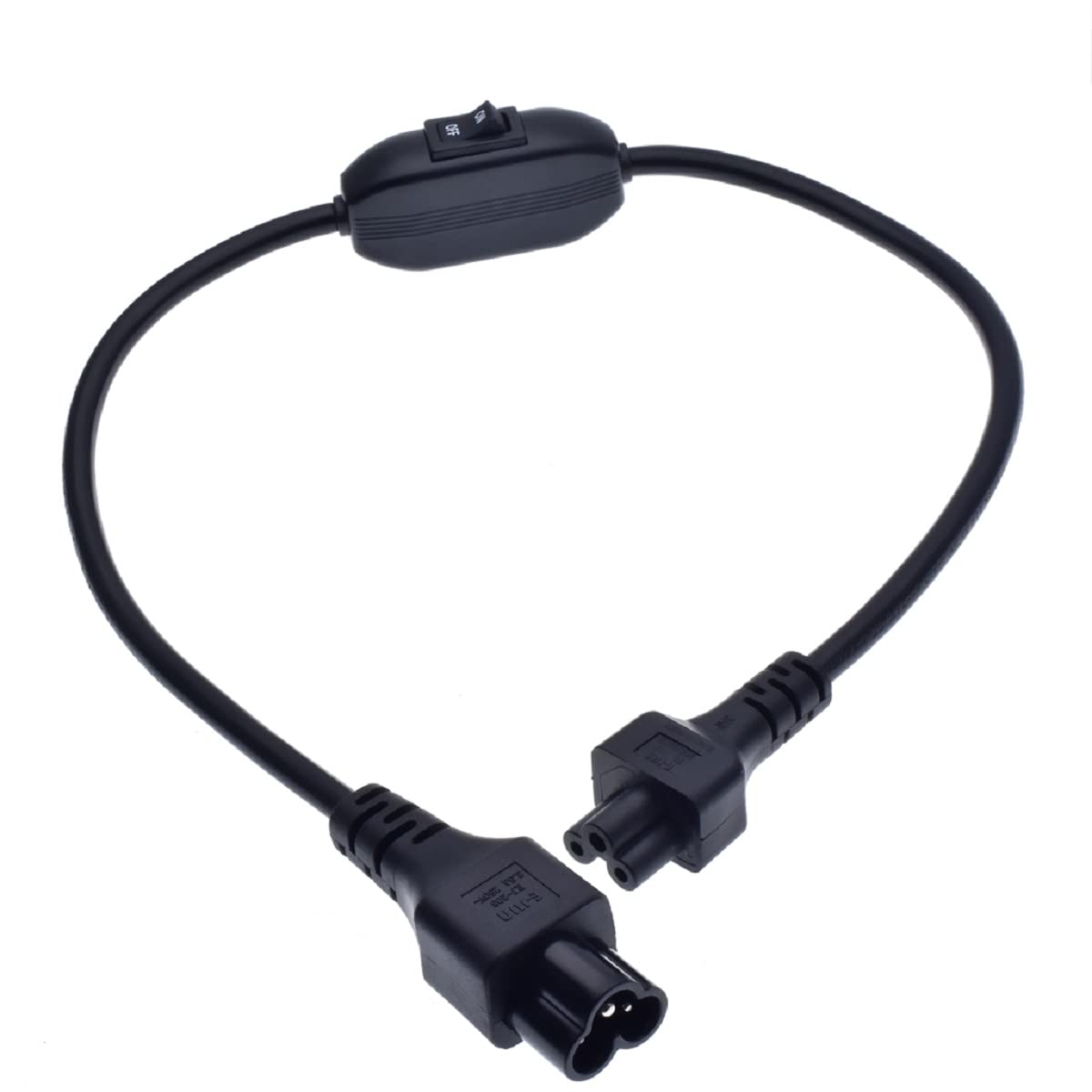

The riser originally came with a sata adapter cable which I didn’t really have space for. For my purposes I actually used some old J-Hack M2426 cables that can be repurposed. Luckily, for whatever reason, this 5080 only pulls ~3W or so from the PCIe slot so I don’t think these cables are getting overloaded. One issue that arises when using a riser that is externally powered with a motherboard that does not support the PSON function is that the PSU needs to be permanently jumped on, which results in the riser always supplying 12v to the GPU. My RTX 5080 pulls 30-40w even when the system is shut off – this can quickly lead to overheating and failure if left without cooling. This introduces the need for an external switch. I grabbed this switch from amazon. This does create a two step process for powering on and powering off the PC, but it is a small price to pay.
