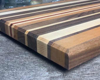

Really liking how this is turning out. Food for thought…Have you considered a mixed wood front?
thanks! oh, that's a nice idea I haven't thought about... given that the front panel can be changed easily I'll probably keep playing around with different styles in the future... e.g. something I wanted to try is split panels in different materials/colors and maybe something like "speaker mesh"...
