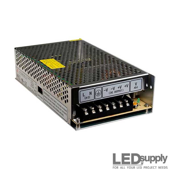

  4. Next to the video card, a SeaSonic SS-350M1U. It's longer than your ordinary Flex ATX but it could be pushed out so it starts at the end of the video card PCI flange. This adds about 1.5cm or so which is badly necessary for the cables. I have several reasons to pick this particular PSU: zero fan mode until about 150W. Two, as the disassembly shows, no heat sink covers it. So an alternate cover could be made from a material like http://www.ledsupply.com/images/products/12v-of-xxa.jpg this and then two 10mm thin 80mm fans could be attached to the case cover just above the PSU providing a ton of quiet cooling capacity ( I would let the user install the custom cover and unplug the factory fan...). Three, it's modular and it shouldn't be that hard to get a custom harness made. Perhaps this company? Or the famous Kareon Cables, we could have low profile PCIe connectors.. But this is just a small detail :) Anyways, a custom harness would make the case extremely neat, all the power cables running to or under the video card, barely surfacing to plug into the ATX and P4 port. I would add two 8 pins so the 1080 Ti Mini can run. It's only 250W. The CPU is only 65W up to the 7700. So the power envelope fits.
