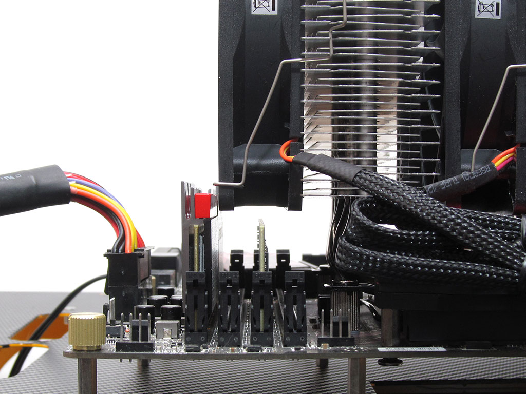

After researching a lot of compact cooling possibilities, I honestly think that the Ncase M1, with its support for dual 240mm radiators might be the perfect SFF case for the 10+ core ITX builds on the 2066 platform. Sure, it would require a custom loop but 2x240mm radiators shouldn't have a problem keeping a top of line i9-7900x (or higher) in check with some additional headroom for overclocking.[USER=433]@chx[/USER] Yes! The Scythe Fuma is awesome. At just 149mm high, it trades blows with the much larger 160/165mm HSFs and 240MM AIO solutions (source). Outside of the stock sleeve bearing fans, my only concern is ram clearance, so provided you have enough headroom to accommodate for the fan being slightly offset, I think that the Fuma will score quite well among the SFF community.
