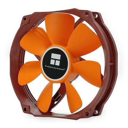

Fan
TY-127BP
Size: L130 x W120 x H25 mm
Weight: 130 g
Speed: 60-1500 RPM +- 10%
Noise: 19-23 dBA
Airflow: 28.32-84.97 CFM [48.116-144.3649 m3/h]
Static Pressure: 0.3-1.89 H20
Current: 0.20A
Bearing: FDB

This fan vs Noctua NF-A12x25 might be a toss-up. We'd have to see the P/Q curves to be sure. The airflow is a littler higher, but the static pressure is lower. But what actually matters if the few points of the curve where it will actually be working at, not the zero pressure max air flow. Noise should be vaguely similar.
Wonder what those fan mounting points are. If they are standard 92mm or 120mm, then this fan seems hassle free to replace for another either better looking or better performing fan. If it is nonstandard though, that could be a bit of a pain.

It's not quite standard. It's a 130x120. And if you notice, it has a very thin frame on the top and bottom.
I think it will still have standard 120mm mounting holes.
