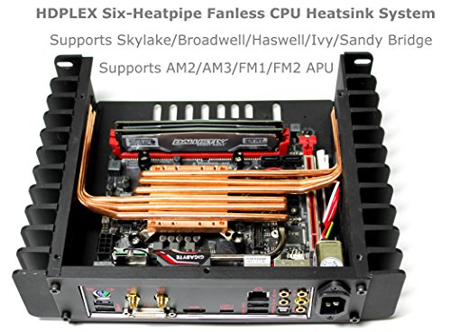

I'm looking for a fan to pair with a passive cooling system (most likely a vapor chamber and some heatpipes going to case-fins).

So I guess a graph comparing 'pressure' is also important.... I'm considering putting as many holes as possible in the case for maximum airflow, and then covering all the holes with anti-dust-mesh. Part of me would like to have something water-tight, but I don't think it's at all practical. I had an idea before to make a passively cooled/airtight system, and just put it on top of a laptop cooler, but I don't think I could get the heat to move into the case efficiently enough.
