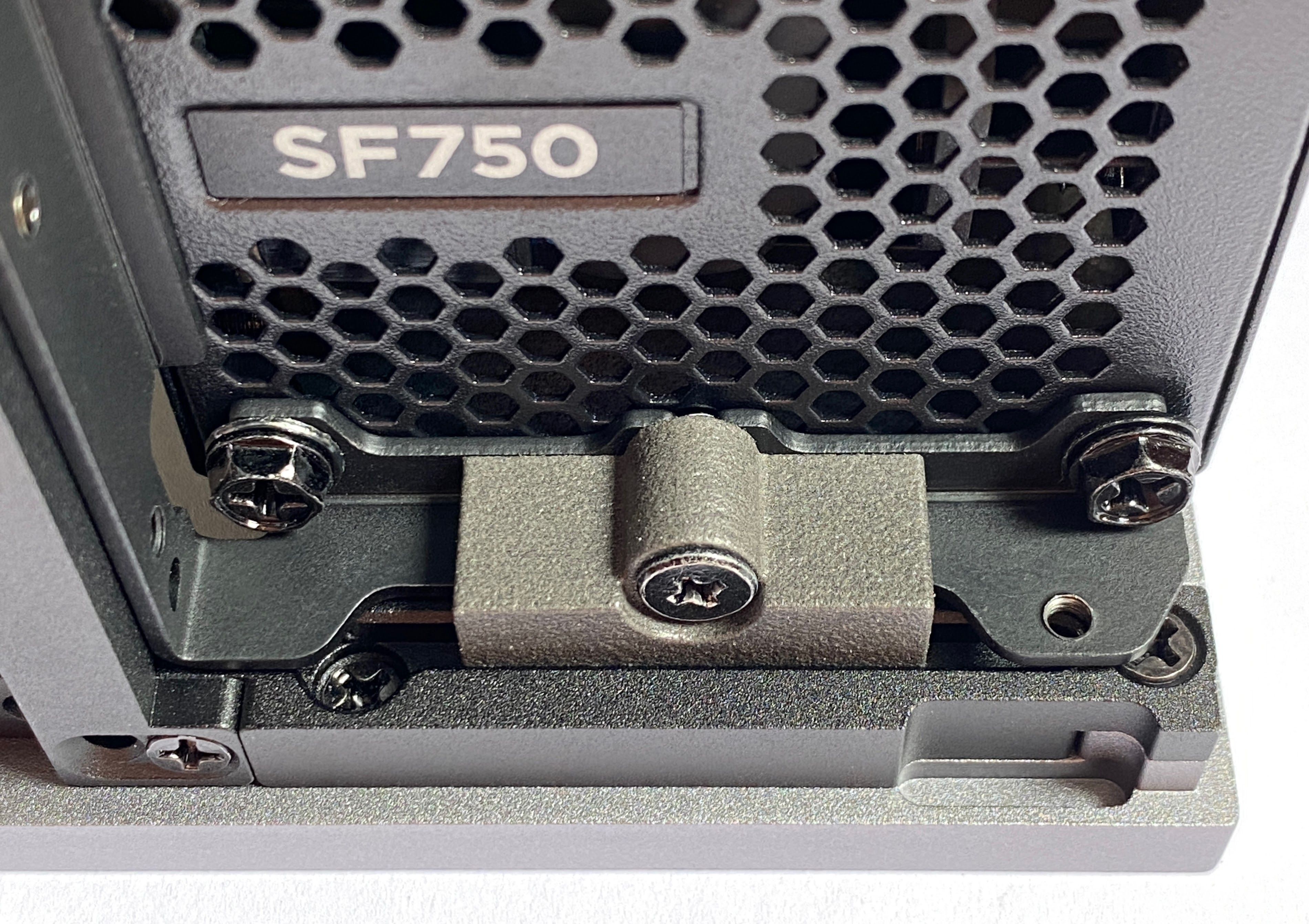

Zurath submitted a new resource:
FormD T1 v2 - PSU bracket clamp - formd t1 v2 psu mount bracket clamp
So I designed and 3D printed a clamp for PSU bracket to solve the problem of original design and it works very well. There's zero wobble and it uses one of PSU mounting holes to attach. Aside from that part you gonna need a 6-32 screw with length of around half an inch (13mm).
You can take the attached STL or export from Onshape to...
