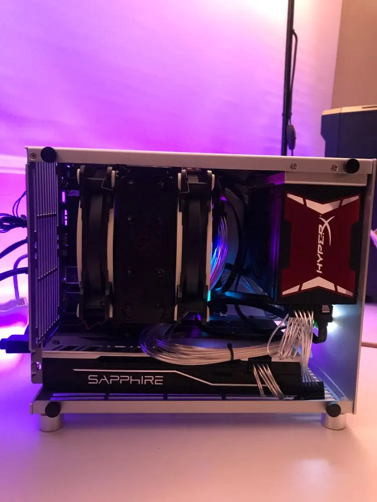

This case is perfect for me except I have a small m-ATX board (226 mm x 185 mm) and a sound card
I want the case in the photo except it should have space for a small m-ATX board.
Ideally, there should be 3 or 4 slots for both a video card and a sound card but two rear slots may be enough.
Case width must be no wider than 150 mm.
160mm is too wide.
I will transport this case inside an airplane carry-on suitcase. The max width is 150mm.
Maybe I could squeeze in a slightly wider case but I prefer not to try.
